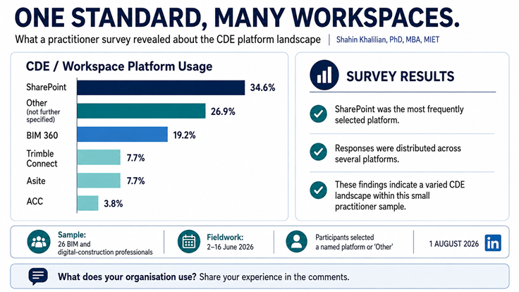

To get a small snapshot of this landscape, I included a question about day-to-day CDE software in an exploratory survey of 26 BIM and digital-construction professionals. The survey ran from 2 to 16 June 2026. Participants could choose from several named platforms or select “Other”.
What the snapshot showed
The responses did not point to one dominant product. SharePoint was the most frequently named individual platform, while dedicated construction CDE products collectively represented a slightly larger share.
CDE / workspace platform
Responses
Share
SharePoint
9
34.6%
Other (not further specified)
7
26.9%
BIM 360
5
19.2%
Trimble Connect
2
7.7%
Asite
2
7.7%
Autodesk Construction Cloud (ACC)
1
3.8%
Total
26
100.0%
Dedicated construction platforms (BIM 360, ACC, Trimble Connect and Asite) accounted for 38.5% of responses in total. SharePoint alone accounted for 34.6%, and the unspecified “Other” category represented a further 26.9%.
The finding that stood out to me
The most important result was not which product came first. It was the level of fragmentation. A general-purpose collaboration environment appeared alongside several purpose-built construction platforms, and more than a quarter of respondents used something outside the named list.
This matters because a CDE is more than a place to store files. Its value comes from the governance around those files: permissions, status codes, review gates, approvals, revisions, transmittals and audit evidence. The same governance intention may need to be configured very differently in SharePoint, Autodesk Construction Cloud, Trimble Connect, Asite or a bespoke internal system.
