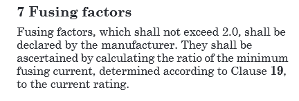

Could you please confirm whether clause 431.1.1 (iii) in BS 7671 is accurate and up to date?
As per the requirements of BS 7671, a circuit breaker may take up to one hour to trip when subjected to a current of approximately 1.45 times its rated current. In such cases, we would like to clarify whether the associated cable is also designed to withstand 1.45 times its continuous current-carrying capacity for the same duration without degradation or thermal damage.
Is this aspect covered in any cable standards (such as BS 6004, IEC 60287, or IEC 60364) or specified in cable manufacturer datasheets?

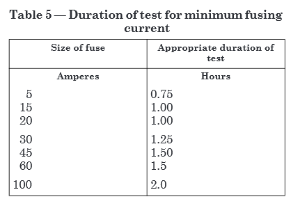

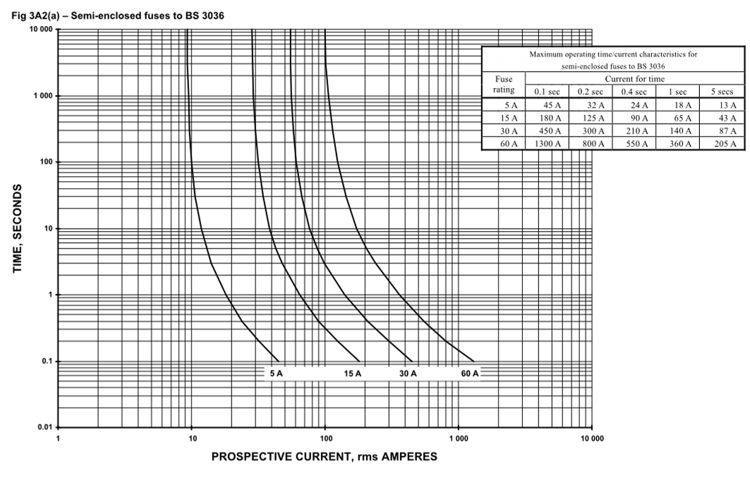

  • It is there because you have to have a gap between the current that any real breaker can carry all day without tripping - it's full load current, and a higher value, the highest current it might not trip at. Above that are current levels at which it certainly will operate, with increasing speed with increasing currents.
    That 1.45 figure is the width of that uncertain region.
    So a 32A breaker can take 32A all day , at full temperature. It is certain to trip within 1 hour at around 40A, but between 32A and 40A is a grey area, where what it does will depend on the day, and where in the natural scatter of the production line that one particular breaker sits.

  • Can cables reliably withstand 1.45 times their rated continuous current
    Yes ... but not for an indefinite time. Hence, also the requirement of Regulation 433.1 'Every circuit shall be designed so that small overload of long duration is unlikely to occur'.

    The missing piece of the puzzle lies between In and a full blown fault current (Section 434). For protection against fault current in general, Regulation 434.5 applies ... Regulation 434.5.2 makes the assumption (because the short duration of the high current fault), that no heat is lost from the outside of the cable during the fault ... we call that an 'adiabatic approach'.
    For faults currents that take over 5 seconds or so to disconnect, the estimates of the adiabatic approach no longer apply, and more current can be handled than the formula in 434.5.2 shows. We can then use the 'non-adiabatic approach' explained in BS 7454 to calculate what the cable can withstand.
