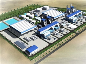

    [Credit: Mitsui]
    Good, some facts!
    "The plant will be equipped with Ansaldo GT26 class gas turbines, with a net generating capacity of 235MW each, and two steam turbines with a capacity of 284MW each. The project will also comprise four boilers".
    So somewhat bigger than I speculated and about 1,000 MW of waste heat to dump!
    " Ansaldo Energia will supply the main power train equipment components, including, for each power plant, four GT26 gas turbines, four heat recovery steam generators, two steam turbines and six turbo generators, to SEPCOIII (Shandong Electric Power Construction Corp) of China "

  • The picture of the power station in Oman is using an air cooled condenser as against a cooling tower, which is historically more common in the UK. Both can be used by coal fired power stations and CCGT plants like the one in Oman. The third alternative is direct cooling, usually using seawater, but can be from lakes or rivers if the supply is adequate.
    Direct cooling is the most efficient, followed by cooling towers, with air cooled condensers being the least efficient.
    All UK nuclear power stations are direct cooled, but cooling towers are used in other parts of the world.
    Modern UK CCGT power stations with cooling towers use the lower height forced air type i.e. they have a fan, rather than parabolic shaped type, which are more efficient, but more expensive.
    The choice of cooling used for nuclear, coal, oil, gas and CCGT plants depends on water availability, environmental constraints and cost. The three cooling technologies will work in each case.
