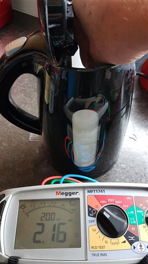

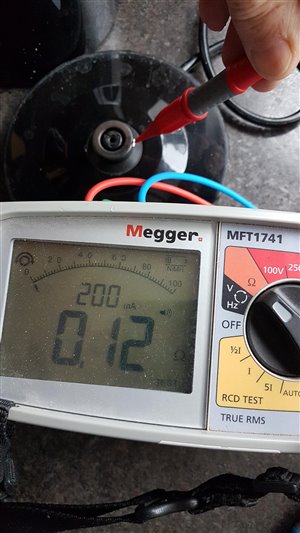

  • The biggest issue with doing an earth continuity test on a Class I plastic kettle element is scrapping the lime built up on it off to get a low reading.
