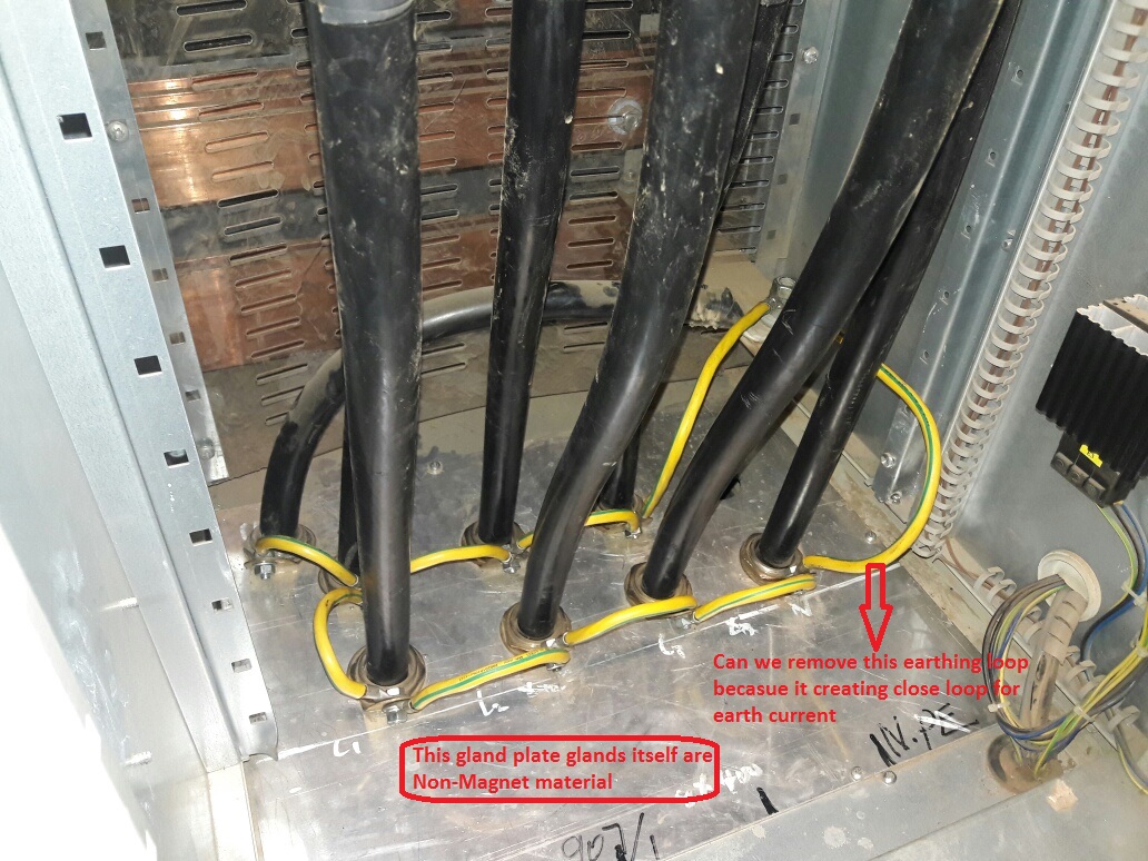

Hello Electrical Team.
I would like to discuss an issue being facing in our Power plant(90MW). Our plant generation voltage is 11KV & Plant auxiliary & MCC voltage is 400V AC 50Hz. We have two sections of Power plant PP1 & PP2. In PP2 we are facing issue in LV MCC Panels.
In LV system we have two BUS A & B. Both BUS's are getting power from their individual T/F(11KV/400V AC) & from here power is distributed to various MCC panels in plant.
Booster no. 1 MCC have two LV breakers(Q1 & Q2) which are getting power from BUS A & B.
During last week we were found that Q1 breaker incoming cable insulation was melted around the cable gland area & checked the other glands also & they are also found overheated with abnormal temperature. then we took changeover to Q2 breaker but this is also now getting overheat. In main LV distribution panel side also cable glands are getting overheat which are connected to Q1 & Q2 breakers in MCC.
In one phase two cable are laid & connected, size is 400 sq.mm Armoured cable. R phase(L1 & L2), Y Phase(L1 &L2) & B Phase(L1 & L2). The current also not equal in two length of each phase.Pl see the below readings.

    As per the preceeding reply's i came to noticed that some of the points regarding our LV system is not clear so let me elobrate the system bit in detailed.
    Pl see the attached following below files,
    1. LV System SLD concerned breakers position are marked.
    2. Q1 Breaker cable entry & gland earthing condition. Q1 & Q2 cable & gland arrangement is identical.
    3. Q7 Breaker cable entry & gland earthing condition. Q7 & Q10 cable & gland arrangement is identical.
    I think if the proper gland earthing will make then this issue will be sorted out. Kindly also share the correct way of gland earthing.

  • These are single-core cables, yes?  Are the glands brass (non-magnetic), or are they steel, or cheap fakes steel coloured to look like brass?  A steel gland on a single-core cable will get hot.  Check them with a magnet.  Is the gland plate steel, or is it aluminium?  If the gland plate is steel it needs to have a slot cut between the holes for the glands so that there is not an unbroken circuit in magnetic material around a single conductor or a single phase.  Where the cables are armoured I assume they are AWA?

  • Is the current flowing in and out under each gland compensated ?  I am not too sure from your description if each gland surrounds 3 phases,  and there are 2 glands in paralllel, or if there are 3 glands, each carrying two cores but of the same phase each.
    For best results you need flow and return currents within any one hole to be near zero sum,  ie. all 3 phases - if not then two effects occur -
    The first is magnetic heating of any magnetic metal that the cable passes through - typically problems arise with cables entering thick walled steel boxes.  A simple saw cut connecting the holes for flow and return current fixes this. If need be that slot can be back filled with epoxy or braze metal, anything  interrupts the magnetic path forming a loop around an un-cancelled current in the steel
    Nor is it clear what the armour of the cables is made of - steel armour suffer the same problem.
    The second problem is one of induced currents - if an un-cancelled current flows in cable inside a metal sheath, and it does not need to be magnetic, this introduces a voltage along the braid/ armour . Put two such armoured cables carrying different currents, and connect the armours at both ends, and a one turn air cored transformer is made, where the primary is the wanted current, and the armour forms a shorted secondary - the voltage is very low, but so is the resistance around the loop, especially with aluminium armour, The trick is either to have insulated bushes under the load end glands on all but one cable, so the armour is earthed at the origin but the shorted loop is broken. (or an insulated plate for the glands to bolt to, and then a separate earth connection - often the glanding boxes have a removable panel to make this easier.)
    Or one can break the armour in the middle, and cross link the armours from different phases, so that the induced voltages more or less cancel or at least the total voltage on each armour is a sum of so many metres of phase 1 and so many metres of  phase 2 and so many metres of phase 3.
