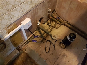

  • A negative head single impeller shower pump to fill the new bath up with hot water before it goes cold and to over power the thermostatic mixing valve in the new mono block mixer tap.
    That is a pressure vessel sitting on top of it that helps it to know when someone has turned the hot tap on.
    Once again it will be plastic pipework from the new isolating valves to the mono block thermostatic mixer tap mounted in a fibreglass bath with a plastic waste pipe, the risk of electric shocks whilst using the bath is minimal, it’s the old basin and taps that were retained that presents a risk due to possible faults outside of the bathroom livening up the pipework to it and its taps.
