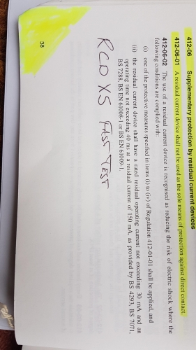

    I'd assumed that the references to "supplementary protection" and "additional protection" meant the same thing - after all BS 7671 itself used to use the term "supplementary protection" to mean what we now call "additional protection" (e.g. 16th Ed BS 7671:2001+AMD2:2004 reg 412-06 "Supplementary protection by residual current device") - i.e. I  suspect there's no more significance in the use of the two different terms than that the writers of BS 7288 haven't been entirely consistent in adopting the new vocabulary.

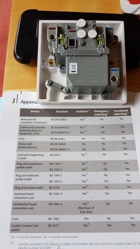

    Then 531.1.1 : Devices for protection against electric shock by ADS shall be suitable for isolation in accordance with chpt 46 and 537.
    There is the table for 537 as a "guide" for suitability for switching/ isolating etc. In the RCD bit it lists BS60947-2/61008/61009 as okay for isolation. Ah you think! But a removable BS1361 fuse , a switched fused connection unit, a plug and socket are also all suitable for isolation as listed in same table.

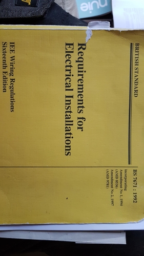

    In my time working as an electrician I have had to buy seven editions of the Wiring Regulations,  this is the first one I bought and have on my shelf.
    So when I started working as an electrician there clearly was not any issues about using BS7288 RCD devices,  bearing in mind that then and now they are made to the British Standard BS7288:1990, which is still current for a few more weeks. Exactly how and why was it decided that there could be an issue with these RCD devices? I suggest that there is no issues with the BS8277:1990 versions, only the new BS8277:2016 versions that are just now being released for sale.
    Also I am still making alterations and additions to electrical circuits protected by BS4293 RCDs, but they are no longer listed in the current Wiring Regulations,  so is that wrong, is there an issue about using these to provide RCD protection? If there is an issue millions of consumer units with working and safe RCDs that need replacing to undertake minor alterations and additions to existing electrical installations.
    Andy Betteridge
  • Also I am still making alterations and additions to electrical circuits protected by BS4293 RCDs, but they are no longer listed in the current Wiring Regulations,  so is that wrong, is there an issue about using these to provide RCD protection? If there is an issue millions of consumer units with working and safe RCDs that need replacing to undertake minor alterations and additions to existing electrical installations.
    I'd say that there's no more of an issue than re-using red & black cables (which won't conform to the current version of BS 6004), BS 3871 MCBs or BS 1361 fuses. If anything a properly functioning BS 4293 RCD might even give better protection than a modern BS EN one - being that they'll disconnect within 200ms instead of 300ms (at 1x).
    Further to what Alcomax said above, I pointed out in another discussion that ended up drifting onto this subject that FCURCD devices are manufactured to two British Standards, BS8277:1990 and BS1363-4:1995, so are perfectly capable of providing isolation, the IET says so.
