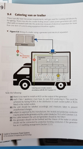

  • Yesterday I bought the new IET Guide to temporary power systems practitioners guide, published this year 2019.
    I may be about to get involved with a Santa's sleigh mounted on a trailer with a generator,  lights and sound system, so I was looking through my new reference book and spotted an anomaly.
    Never say never?
    Andy Betteridge
