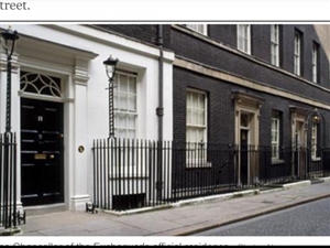

As I'm sure everyone has noticed of late, No.10 Downing Street has a nice electric lamp for its front door - supported by an arch from the iron railings. Similarly, immediately next door to the left (contrary to usual UK practice, designated No.11) also has lights fixed from the railings - two in this case, at least one of which appears to share the same railing system as No.10.
If pictures help: No.10 and No.11
For the sake of this discussion let's assume No.10 and No.11 have separate DNO supplies and the light fittings are all Class I.
If you had to do the design for feeding the lights outside either or both premises (and had no ill-intent to the occupants) what sort of earthing and bonding arrangements would you specify? (and would regulation 714.411.3.1.2 figure in your thinking?)
