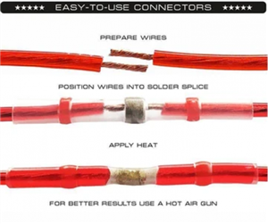

  • Do not confuse a crimp lug with a solder lug - you can use one as the other, in that you can solder wire into an oversized crimp lug,  though some solder lugs are wrap round and  could never be crimped, but you should not really mix the techniques.
    There are some rather nice solder paste filled connection tubes that can be used with a very hot heat gun. this sort of thing  They are a step up on twisting the wires with a swizzle of solder wire inside some aluminium foil and heating it with your lighter, as the heat-shrink insulation is part of the design.
    Better on PTFE wire than PVC or polythene, which tend to melt and run away from the heat, so probably better for aircraft repairs than domestic wiring.
