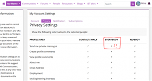

  • Sparkingchip for his PM. For some reason our wonderful new forum software won't let me reply
    Possibly that is because Sparkingchips options are set to not accept Private Messages
  • Lol.
    I thought the message service was just to tell you if you have a new badge!
    Andy B.
  • Well in your case I imagine it does not look like this (my settings)
    Once turned on you are open to the undercurrent of private messaging, assuming anyone wants to talk to you.
    I do not get the junk mails  about "badges" anymore, that is under the 'notifications' tab.
    realise that 'anyone can see your profile' only means folk who are logged in, which as
    I am mostly out unless I wish to post, has tripped me up.
