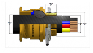

    I have some CXT gland kits if you want try a third type.
    Andy B.
  • Looking at the CXT type, they look like the ones used for SY and similar braid with thinner wires - you can comb the 'hair' into pigtails, one tail per slot an then a locknut and washer  captures the pig tails to the body.
    I've not seen that type of slotted armour contact  for SWA - I;d imagine it is not so good to kink the thicker wires too sharply., and may be quite hard to do well.
  • That’s the kit.
    No cone and olive with slots to bring the pig tails out of. They look the same when assembled.
