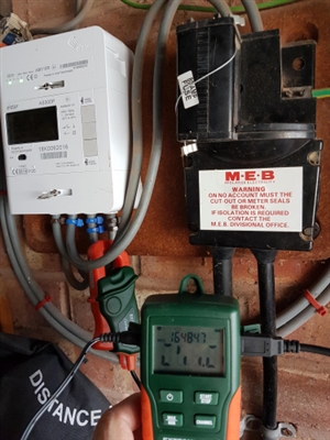

  • I think a photo of the DNO intake at my house is enough for an OLEV grant application to be rejected.
    So as a contractor I probably would not want to do a free site survey for installing an EV charger at home until the DNO have upgraded the supply.
    Ignore the display on the data logger, I have been going to start a discussion about that for the last week or so.
