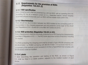

I am hearing from my network of contractors, that have actually read the new 722, that they have been asking charging equipment manufactures for documentary proof to comply with Note 5 of 722.411.4.
They are getting knocked back for asking or in one case a Declaration that says the particular device complies with BS 7671. I think that is wrong to declare that as BS 7671 is an installation safety standard and not a product standard. I believe that as a minimum the equipment must comply with the Low Voltage Directive and be CE marked. I also believe that manufacturers have to issue a Declaration of Conformity.
BS 7671 722 has numerous references to the various standards required such as BS EN 61851 that the equipment must comply with. I am thinking it may be illegal to offer the sale of equipment that does not comply with the Low Voltage Directive and is not CE marked?
I am hoping the countries top man of equipment safety standards, Paul Skyrme , sees this post and will come on and give us his expert view?
Has any forum member asked for a Declaration of Conformity from EV charging equipment manufacturers and received one?

    OK you say what if a N-E fault occurs on the cable or elsewhere in car or charger. This will trip any RCD as a large current (compared to 30mA) will be diverted to the earth conductor, bypassing the N side of the RCD. The small DC signal (lets say 12 mA or whatever) will not prevent this trip. I
    DC core saturation may occur with Type AC RCDs, preventing the trip. IET Article explains.
    In any case to be dangerous we need a second fault, say a lost N elsewhere and a person effectively connected to ground touching exposed conductive parts of the car.
    The danger will be a bit more if the car has finished charging but is still connected, but under this condition we still need a fault and a person well connected to ground, whatever the RCD does.
    Disagree, the N-E fault also potentially causes "blinding" of other RCDs upstream in the same circuit. It also causes circuit current to be shared down the cpc indefinitely which is not really considered "safe" in the UK - we're not allowed TN-C in the consumer installation.

  • OK, but:
    1. The charging cable is Mode 2 not Mode 3 or 4. The two can't be 100 % compared. This is why the requirement for Type B (or Type A or F + RDC-DD) is where the vehicle connector is used, for tehthered cables or Mode 3 / 4 charging station. With Mode 3, there are additional options available for the pilot. Where you have Mode 2 cable, a Type A RCD is sufficient.
    2. When the vehicle is not connected, or if there is a problem in the monitoring circuitry on the vehicle, the source is 12 V. Therefore with a tethered cable on Mode 3 (or EVSE where the cable is left plugged in), we still have the situation that an N-E fault on the cable, which can happen at any time, provides 12 V DC. And the cable is connected at all times.
    I would recommend, if you want to look into this further, to have a look at BS EN 61851-1 (or IEC 61851-1). Quite a lot of areas' library subscriptions will permit you to have a look at the standard on line, although I'm sure the resourceful individual could perhaps find a way to access on the internet in any case.
    I've also seen a number of articles on web-sites about the vehicle charging interface, where the diagrams and info in BS EN 61851-1 (IEC 61851-1) are reproduced.
