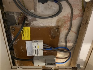

    If the car is charging indoors then TNCS earthing may not be an issue if that is what it is, but otherwise it’s time to get the big hammer out and put a rod in to make it TT.
    That is for the EV charger, there is also the the hot tub to consider.
  • Former Community Member
    0 Former Community Member
    Thanks Sparkingchip‍
    TT I think?828a30314b1cbff09f2c6c344d7c6286-original-9ce0221a-84f0-4a31-8b3e-604c417305d7.jpg
  • It looks like you are off to a good start and can forget about the issues of using a TNCS earthing system as it looks like TT.
    Hopefully you have an appropriate upfront RCD and earth rod, however you don’t want casual connections to the TNCS through shared metal gas and water pipes from neighbouring homes.
