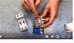

    Inside the wylex and crabtree units are pretty much both  like this  teardown video by efixx .
    I found the spring - loaded solder joint to disconnect and operate the warning flag and micro switch something of a throwback to a bygone era, that reminded me of the old tellys I used to sometimes repair as a teenager and in my  early 20s.
    In the screenshot below you can see how  the  L-E is a just a varistor (semiconductor transorb), the blue thing,  and NE is the gas filled ceramic cylinder with metal caps at both ends - a sort of enclosed 'spark gap'  of more controlled behaviour if you will.
    regards Mike
