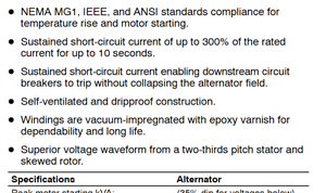

Do I take this into consideration? If so how do I size wire in a building with a safety generator? What is my "Ze" when the supply switches from DNO to the safety generator? How do diesel generators behave during faults?

    From the large print extract:
    Generator can sustain 2.5 to 3 times rated current with a 3-phase fault applied for approximately 10 seconds without damage to alternator.
    The alternator windings may well be able to, but I'm struggling to accept that the associated prime mover can produce 2.5 to 3 times it's rated output for a second, yet alone 10 seconds. What size is the flywheel?!!!!!

    How can the text extract not be accurate when coming from a reputable manufacturer? All the generator specs I'm looking at indicate that generators <500kw are capable of exporting short circuit current between 3x to 10x for some amount of seconds. For example, 300% for 10 seconds:
    http://resources.kohler.com/power/kohler/industrial/pdf/g5438.pdf
    I'm also confused when you say 10% will be lost to reactance when reactance itself is not real power. I'm also under the impression that reactance actually causes a generator speed up vs slow down.

    Is it possible that the engine can indeed output 300% power for a few seconds? Or that the AVR ramps down the voltage but keep the current high in the fault loop such that the engine is loaded to 125% instead of 300%? Or the reactance of the fault might not actually load the engine up to 300%?
    It has to be one or a combination of all 3, but to be honest I'm confused more than anyone else.

    Here is the data page claiming 300% current in order to clear down stream breakers:
    https://kohlerpower.com/en/generators/industrial/product/350reozjd

  • Interesting, because you have answered your own query. These are permanent magnet alternators and probably on very small machines with oversized engines. A short circuit on a conventional (synchronous) alternator will remove the voltage from the AVR (which is powered from the output terminals in most designs), thus removing most of the magnetic field from the rotor. This is a deliberate safety feature to prevent winding damage and mechanical failure. All the other details there suggest that these machines are intended to live a hard life outside, The data missing is how the voltage control works, although there could be some clue from the pilot-excited phrase suggesting that the permanent magnets only give some of the rotor field, the rest being from an AVR. The superior waveform claim is curious too, the rotor design normally is modified to give excellent waveforms from the machines I have seen, often a very small harmonic content with a resistive load. Bad loads can of course change this, but this is not really a function of the alternator. Please post the spec or a link for the data you are quoting, I would like to see exactly what we are discussing.
    Well, don't think its answered for certain. I mean I don't know what the output voltage will be at those 300% amps is. In theory lower voltage means less current through a given impedance, so resistance or reactance from the conductors could limit current below 300%. I don't know for sure.
    Here is the PDF:
    http://resources.kohler.com/power/kohler/industrial/pdf/g5620.pdf
    Here is site listing:
    https://kohlerpower.com/en/generators/industrial/product/400reozjc

    <snip>... These are permanent magnet alternators and probably on very small machines with oversized engines. A short circuit on a conventional (synchronous) alternator will remove the voltage from the AVR (which is powered from the output terminals in most designs), thus removing most of the magnetic field from the rotor. This is a deliberate safety feature to prevent winding damage and mechanical failure. All the other details there suggest that these machines are intended to live a hard life outside, The data missing is how the voltage control works, although there could be some clue from the pilot-excited phrase suggesting that the permanent magnets only give some of the rotor field, the rest being from an AVR.  <snip>
    I suspect it is more like one of these.
    The permanent magnet part is really only a big brother of a bicycle dynamo in that it provides the 'pilot power' that is AC that is then rectified to provide DC power to the electronics in the AVR controller that is setting the Exciter field, and perhaps to supply some ancillary electronics for engine management and cranking battery condition as well. The AVR senses   voltage and current readings  from the outbound phases to decide exciter level, but is not depending on it for the excitation power to the armature.
    The fact that the AVR does not lose its supply  when the output voltage collapses is both a benefit and a risk, as you point out, depending on the avr details it keeps going in fault state, but it also recovers more gracefully with spiky loads
    The bigger machines by Brush all work on this basis.
