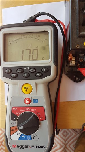

  • I can make a RCD trip using the continuity tester as it’s pushing out 200 mA, I cannot make the VOELCB trip with it.

  • Whilst I was measuring the resistance of the VOELCB coil I didn’t take into account it will be a resistance in series with the earth electrode. ?

    Knock me down with a feather!
    I never thought to turn the cover over.
  • Sparkingchip:
    I have the same model and it reads the same 170 Ohms across the coil. Inside the bottom cover details are provided.
    Max. earth resistance 500 Ohms.
    IMPEDANCE of E.L. trip coil 500 Ohms.
    Minimum tripping current 35mA.

  • I just happen to have a VOELCB in my garage, I really must get rid of some of the stuff in there!
    250 mA passing through the actual device from terminal F to E?
