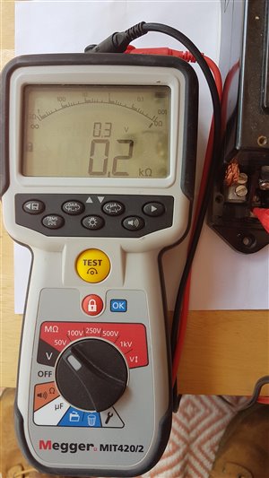

  • I just happen to have a VOELCB in my garage, I really must get rid of some of the stuff in there!
    250 mA passing through the actual device from terminal F to E?
  • Sparkingchip:
    I have the same model and it reads the same 170 Ohms across the coil. Inside the bottom cover details are provided.
    Max. earth resistance 500 Ohms.
    IMPEDANCE of E.L. trip coil 500 Ohms.
    Minimum tripping current 35mA.
    Z.

  • Whilst I was measuring the resistance of the VOELCB coil I didn’t take into account it will be a resistance in series with the earth electrode. ?

  • I can make a RCD trip using the continuity tester as it’s pushing out 200 mA, I cannot make the VOELCB trip with it.
  • Don't trust the tester to push out 200 mA.  Measure it with another meter in series [as well as the VOELCB coil].  Or connect the coil to a car battery.   The tester should test with e.g. 200 mA to a near-zero resistance, such as a conductor through an RCD.  But if the VOELCB's coil really is tens or more of ohms of resistance, your tester is unlikely to produce the required voltage to get 200 mA [or 35 mA] - it probably only runs off a few AA batteries.
    500 Ohm Impedance in series with the earth rod. (A.C. supply).
