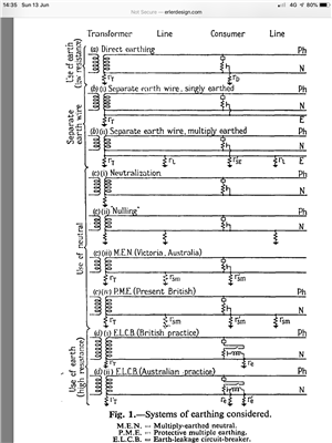

  • In that second document I linked to there is a good diagram comparing methods of earthing, the Australians used two earth rods with a VOELCB as in the diagram I posted earlier, being the Home Office recommended method.
  • Sparkingchip:
    Indeed the diagrams are very interesting. I will study them more thoroughly when I have had my afternoon nap and am fresher. Australian r'e on the right must have a bridge over the N conductor. I could not quite make it out, and initially thought that it must be a joint to N. Do you have a clearer image please? I think that re electrode on the left is the consumer's earthing electrode, and r'e is the V.O.E.L.C.B.s earth electrode that we called the "E" terminal of the device. Both electrodes must be isolated from the N terminal. The right hand r'e electrode must be positioned out of the resistance area of the left hand electrode.
