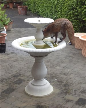

    When we had the concrete, etc. relaid at the back of the house, provision was made for Mrs P's fountain, which is visible from the kitchen window (and my lathe room).
    The ground worker was instructed to lay some black ducting, but in the event, he used a bit of blue water pipe. I couldn't help feeling that putting in some SWA to the pump was a waste of effort. Said pipe sits in the ballast an inch or so below the block paving. Frankly, I think that any act which could disrupt the cable would be either reckless stupidity or malicious.
    ETA: here it is. And yes, that is an effin' fox. ?

  • Had the wiring made the fountain live, it might have fixed the fox problem.?
    Just needs the pond to be made the stinger part of an electric fence.
    Probably a bit of fig 8 speaker cable in an off cut of  hose pipe would do for a few hundred watts of pump , but it is not in the high consumption style that our society requires.
