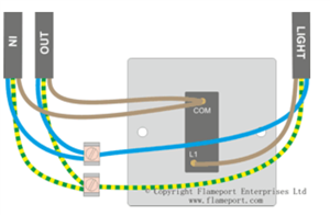

I want to install smart light switches in my “dwelling”. I have encountered issues where the current back box is standard 74x74x25, but I would need extend it to 86x86x38 for the new light switch.
I want check do I need part P certificate, or planning permission? How to be compliant while minimise the cost? (I have no experience in dwelling electrical work)

    I understand the image from flameport website does not have a real natural wire. And in the post above, the natural wire is "borrowed" as an output of the switch, which is actually live.
    The picture of the back box I posted is a 1-way switch, with a loop at the switch. So the two of the incoming T&E wire are from the source and to the next switch (with their live connected to common), and the other wire is connected to the light bulb. All the natural and earth wires are connected, which confirms that no borrow exist. (Like the image below)

    The brown in the T&E at the top is an unswitched line - it comes either from a ceiling rose or junction box. The blue oversleeved in brown is the switched line - that goes  back to the ceiling rose or JB where it is connected to the line of the luminaire. In those diagrams, there is no neutral at any of the switches except the loop-at-the-switch diagram.
    ETA: you appear to have loop-at-the-switch in the example which you show. You would have your two unswitched lines in common, the switched line in L1. Then you need to add a wee bit of blue cable from the neutral block to your smart switch, assuming that it is mains-powered. All the CPCs remain connected to each other and the switch if it is Class I.
    As for abandoning the 2-way cables, I'd keep them rather than chop them off. Ideally all the conductors should be earthed at the supply end.
