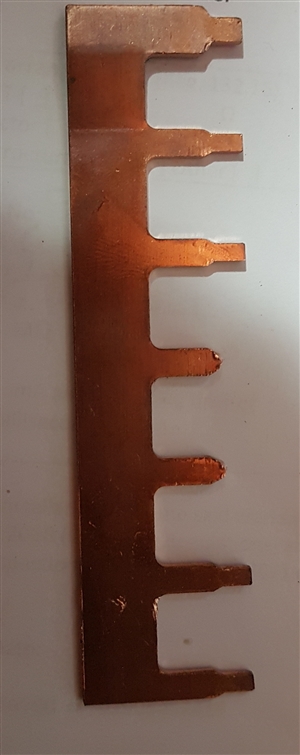

    There's no prohibition on mixing parts from different manufacturers in a single bit of switchgear. However, you then take on the responsibility of ensuring that the whole enclosure complies with BS EN 61439 including (I'm guessing here, not having the millionaire income necessary for easy access to such standards) the ability to not arc on 6 kV spikes, on the enclosure's ability to contain hot gases from CB's breaking of short circuits, that devices adjacent to each other at max load don't overheat, etc.
    Mostly covered by the new metal biscuit tin enclosures with a hinged access cover.
    Z.
  • There's no prohibition on mixing parts from different manufacturers in a single bit of switchgear. However, you then take on the responsibility of ensuring that the whole enclosure complies with BS EN 61439 including (I'm guessing here, not having the millionaire income necessary for easy access to such standards) the ability to not arc on 6 kV spikes, on the enclosure's ability to contain hot gases from CB's breaking of short circuits, that devices adjacent to each other at max load don't overheat, etc.

    This is an interesting point, it comes back to the whole idea of standards for everything …
    It is also interesting that BS60898 does not appear to describe mechanical dimensions …
    I think that Sony learned the lesson of standardization with Betamax even though it was better than VHS.
    I have had a quick shufti through BS 60898 and I cannot even find a reference to a width of 18 mm. It must come from somewhere. ?
