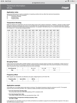

    The issue being, that OCPDs heat up. We simply don't have enough information to determine whether it's dangerous … if the mcb's either side of the shower breaker are often well loaded up to a good percentage of their capacity whilst the shower is running the shower breaker ABOVE it's capacity, we really don't know what will happen (except we do, because we've all seen overheating occuring at the CU for various reasons)!
  • davezawadi (David Stone):
     the thermal section is pretty accurate, because it also needs to be very repeatable.
    For the 32 amp MCB the thermal section tripping current is between 41 amps and 24.3 amps depending on the temperature, the stated 32 amps is what it is calibrated to at 30 degrees centigrade.
    As well as the ambient temperature within the consumer unit enclosure you also need to consider the grouping factor. Inside enclosure the heating effect of MCBs installed in close proximity (in groups) needs to be taken into consideration. Certain amount of watt loss from each device will contribute to raise the ambient temperature of the breaker above the ambient temperature of the enclosure.
    In reality a B40 MCB may have a trip current of around 38 amps just sufficient for a 8.5 kW shower depending on the location of the consumer and the temperature of it as well as what level of loading is on the adjoining MCBs , however on the other hand my consumer unit is mounted on a single brick exterior wall in an unheated garage and the MCBs may be barely adequate for circuit overload protection in the middle of the winter when the temperature of the devices in the consumer unit may be 5 degrees or less.
    https://www.hagerelectro.com.au/files/download/0/32587_1/0/TECHINFO_MCBS.PDF

    I think the point that's omitted here, is that a low voltage assembly (CU) has a load diversity factor applied also. For example, if the assembly has a load diversity factor of 0.8, then groups of OCPDs should not exceed that to prevent overheating. If we have one mcb/RCBO that's running at a diversity factor of 1.1, then whilst it might not overheat on its own, two adjacent mcb's running at anything over 0.65 (65%) would tip the balance.
