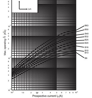

    The I2t for the MCB is also  a variable thing, as illustrated in these plots from a Dorman Smith paper  The let through energies of  larger value MCB's  and that to blow the main fuse cross over in the high kA regions of interest. Not that we need to care too much, but a really low z fault on the shower or cooker cct may well take the DNO fuse with it from a cold start on a  PSSC >6kA  supply.?
    Let-through 1000joules/ohm to  600,000 joules/ohm on Y axis.   PSSC 1kA to 10kA on X axis Not quite square law.

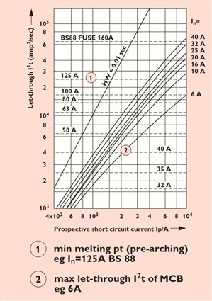

    Wylex MCB curves show similar trends but are not quite the same… (note they use the pre-arc not the clearance I2T for their BS88 dotted lines, so these are minima, not maxima.) Note also the theoretical constant opening time for 10msec (1 half cycle) and how they are all get going quite a bit faster than that, at least to start opening, if not to completely break the circuit. (who knows how many hundred amps dribble through to give a relatively long low energy tail while the arc is dying out on the quencher)
    Y axis 1000 joules/ohm to 100 000 joules per ohm X axis 400A to 10kA
