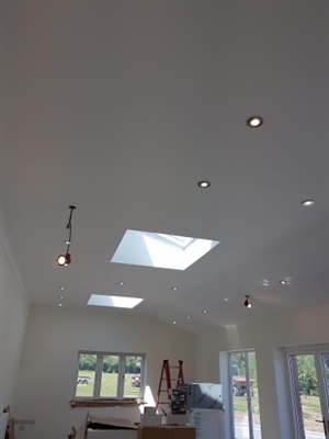

  • Really?
    So how would you set the wiring out on these twenty lights?
    The light hanging down in the foreground is awaiting the installation of a Wago box around the connectors and the other one is awaiting loop testing after powering up.

  • A minimum spanning tree or minimum weight spanning tree is a subset of the edges of a connected, edge-weighted directed graph that connects all the vertices together, without any cycles and with the minimum possible total edge weight.
    I can't imagine many of the more domestic sparks I know chewing on a  pencil and describing  it that way, but if there is access from above that makes one layout easier than the other it will be done following the route of least aggro, using a similar level of native cunning to that required to work out where to aim next on the dartboard. And to me at least, tree and star structures are still legitimate examples of radial circuits, as well as the simple linear chain. Also you may feed any of these layouts from in the middle if there are lights to the left and right of the switch, indeed we have this in the scout hut, the switch by the main doors turns on lights to both right and left of the one in front of the door, as the corridor runs both ways, so you may think its two trees, or at least 2 'Y' shapes one trunk going down each corridor to supply 3 lights, and splitting as a Y because the corridor has a wider stub at the location of the fire exits.

  • for that pic, where is the feed coming from and where are the switch (or switches if it is banked) , and which way do the joists run round the skylights - this will affect the answer.
