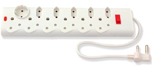

  • Not a few of these ? As seen in ZA, India etc. Accidents are rarer than you think considering what is in daily use elsewhere. Not so keen on the earth free Schuko there I must admit.

  • I'm hoping it's just the persepective making a 3-pin plug looks like a 2-pin one…
