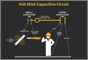

    You have to remember just how simple some of the principles are behind tools and testers that we use everyday, when you actually look at what is happening it’s really basic, this article is worth reading.
    https://voltstick.com/how-to-av/videos-and-blogs/how-does-voltstick-work

  • So the water pipe is only detectable if a tap is turned on and the water is running?
    That is very specific. A volt stick will indicate that there’s a voltage, it will not tell you if there’s a current.
