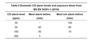

    The BSI limits on concentration and activation time for domestic alarms to be sold are reproduced in the carbon monoxide section of  this HSE report It is not clear cut, as the real problem is carboxy-haemoglobin in the blood, and that is not a convenient parameter to be  measured directly, so certain assumptions are made about the rate of build up in the blood over time at different gas concentrations.  Some folk will in reality be more or less susceptible.
    And we do not want false alarms from normal background levels that may be 10ppm or more indoors when everything is working normally, with short bursts of a lot more when cooking and similar, and outdoor background levels in a town may be 4 or  5ppm , approaching twice that near busy roads at some times of day.
    from that report
