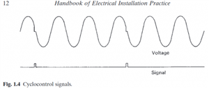

  • Hi broadgage no it was here in weymouth actually the health center which is at the end of my road. I'm in there again tomorow  so unless the appointment goes badly il try to look at the lighting again Thanks for the details of the control system used in London I didn't know that was a thing is it like a zellwegger ripple  control system? If memory serves it uses 1050 cycle ripple imposed on the 50 cycle mains wave
  • The original cyclocontrol system involves changing the waveforms near the zero-crossings
    In contrast Zellweger systems (still used in Oz) superimpose a continuous audio tone of a few volts RMS onto the mains - 1050Hz is one of a number of carrier frequencies used in different places.
