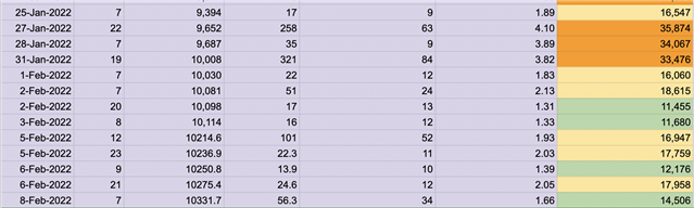

    Here's what it looks like now

  • I am not quite sure what I am looking at here. The date is obvious. I assume that the second column is the time and the third is the meter reading. The fourth column appears to be the consumption since the last reading and the fifth column appears to be the number of hours since, with the 6th column showing the average consumption.
    The night of 2/3 Feb drew an average of 1.33 kW, which is a lot unless there are loads of electric blankets. Then the daytime consumption on 5 Feb was 2 kW, falling back to 1.39 kW that night, and similar again the following day. So what is being switched on and off?
