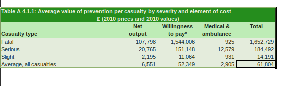

    UK value of life calculations study for HSE
    A1.43 of the green book is supposed to steer policy in such cases
    And the current values used by the govt when doing a proper cost benefit analysis, for example to see if road safety changes in the UK are worthwhile is set in A4.1.1 of the TAG Data tables. Note that we are expecting an update from the 2010 values soon, so expect a few things currently not worth it to shift to be worth it after all.
    Is it so unreasonable  to ask for a similar level of transparency of thinking from the likes of the BSI ?
