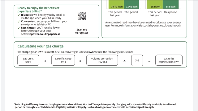

  • This is how my gas bill ends up in kWh, why is it divided by 3.6?
  • 1 W s = 1 J. 1 W h = 3600 J = 3.6 kJ. 1 kWh = 3.6 MJ. So to go from MJ to kWh, divide by 3.6.
  • So:
    gas units used X calorific value X volume correction = mega joules
    mega joules divided by 3.6 = kWh
    which is what I was thinking, just checking others thinking the same.
    If you look at that Canadian link I posted they work it out from the BTU British Thermal Units of the appliances, Boris and Lord Snooty will have us doing the same soon, that will confuse the kids.
  • Do then be aware that the north American BTU, based on the American units,  is not the same as our old one, but differs by a % or so. The therm is also not the same.
    It is indeed set out to catch the unwary. There is  a lot to be said for joules.
