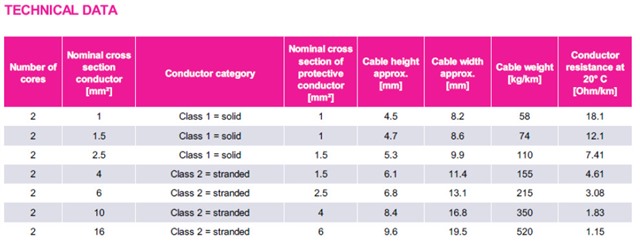

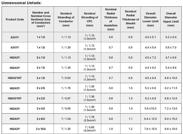

  • I'm not sure 4mm² is particularly stiffer than 2.5mm² - the 4mm² being stranded while 2.5mm² being solid (in T&E at least). It's certainly bulkier and perhaps springier which can make it more difficult to dress nicely and squeeze into shallow back boxes and while all 13A socket terminals accept 3off 2.5mm² conductors, quite a few don't accept 3off 4mm².
  • Yes not that much bulkier or stiffer...
    Found these. Top from Prysmian Cables and Bottom from Doncaster Cables.

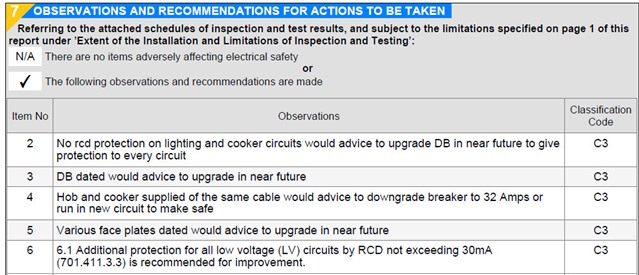

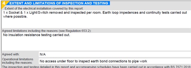

    Looking at the EICR report
    Why no insulation resistance testing?
    Are these items a C3?
  • 2. No RCD protection - fair comment. Recommending CU replacement is a bit steep (EICRs are meant to identify problems rather than dictate particular solutions).
    3. 'dated' of itself does not endanger the safety of the installation (some older accessories are actually better built than modern equivalents) - so unless they're damaged or to such an old standard they they'd no longer be considered safe etc - it's nonsense on a BS 7671 EICR.
    4. I'm not sure if being 'supplied of the same cable' is being reported as an issue, or just a means of identification. If the MCB is rated higher than the cable (and overload protection is required, which it usually would be as we don't relay entirely on diversity), then the bit about downrate or replace cable could be fine.
    5. see 3.
    6. The reg is being taken out of context - 701 series only apply to bathrooms.
