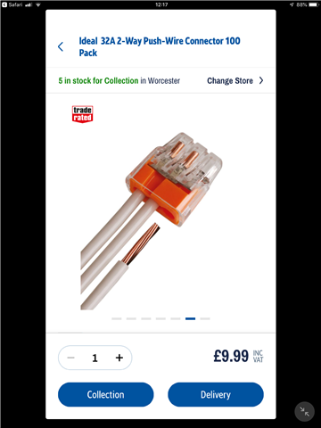

The electrician who wired my (new) home takes the live feed to a light switch in each room (rather than to the rose).  Thus each room has a light switch back box with four neutrals commoned in a WAGO 2273 connector (feed in, feed onward, wiring to luminaire, wiring to spots).  I'm guessing the spots were a surprise to him as he seems only to have had a stock of 3-way WAGO connectors.  He's consistently managed to wedge four 1mmsq wires into a 3-way WAGO 2273.
I know this is wrong, the "extra" wire just can't be clamped like the WAGO design intended.  What is driving me nuts is that nowhere can I find it written down that it is wrong !
  • bit far away for me I'm afraid, and in any case the OP wants the 4 way ones really though the photos do show some sort of stranded conductor and no ferrule.

    I'm a retired electrical engineer (which I realise does not make me an electrician) so when I discovered this I went to Toolstation and bought a selcteion of different sizes. The instuctions ("to be sold only with installation instructions") have an IKEA-like reliance on pictures and though it's very clear that stranded cores are not to be used, it really isn't clear that two solid cores shouldn't be pushed into the same way (but it's not easy to do, which should be enough of a clue !).
    Interestingly, since my original post I found behind a triple switch (bedroom with spots and main luminaire, plus en-suite light and extractor fan) SIX 1mmsq solids commoned in a 3-way lever-type WAGO. Now the lever-type WAGOs are qualified for stranded conductors, so (on the grounds that 2 solids are equivalent to one stranded, then this must be acceptable. Somehow I still don't think so !! As mapj1 says, the only authoritative answer will come from WAGO, but many thanks for all the opinions here.
  • The 773's ARE suitable for both solid and stranded, I have a couple of boxes of those:
    The boxes are both CLEARLY marked suitable for both solid and stranded.
    2273's are a different spec.

    I agree that the box that you showed is pretty clear that the three way connector is for 3 wires only, but the way I bought them from Toolstation (20 to 40 qty) only the 4-way came in a box with equivalent clarity - 2, 3, 5 way came bagged with a sheet that just wasn't as specific.
  • SIX 1mmsq solids commoned in a 3-way lever-type WAGO
    That may not be as bad as it seems.
    The larger size of the newer lever arm Wagos, the 221 accommodates 6 mm² cable. I don't see a lot of difference between 6 x 1 mm² and 7 x 0.86 mm². However, it may not be possible to get the insulation into the tunnels as they should be. (I sometimes have the same problem with wiring accessories: e.g. 2 ends of a ring and a spur may not fit well.)
