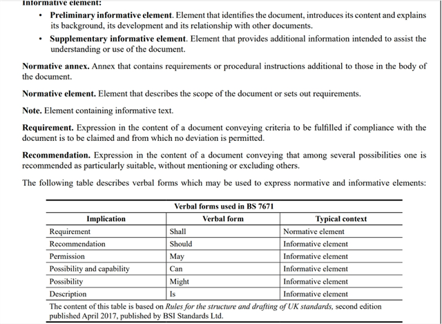

Implications of the term 'recommended' in 7671
In this video: https://youtu.be/aoWuEnvLa3I the term 'recommended' in 7671 is taken to mean that doing nothing is not an option, so applying that to AFDDs means that we have to install them on socket ccts up to 32As in all premises, not just those defined in 7671, unless we can show that AFDDs are not required or their absence is not a problem.
So do you agree with the interpretation and its implication(s)?

  • In a reply in the comments section for the video, efixx state that the doing nothing is not an option, comment, came from the person who wrote the definition of recommended in the regs.
  • that tongue-in-cheek scenario is specious nonsense
    well yes. Except to provoke the thought, that the word recommend is not normally, nor in the regs,  used when declining is not a considered a perfectly realistic option.

  • To help users of BS 7671 understand the meaning of various words for the first time the Introduction provides help on this on Page 18 of AMD 2.
    Hopefully readers will at least grasp the differences between Normative and Informative and Requirement and Recommendation?
