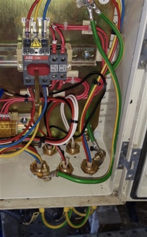

Earthing or bonding ?

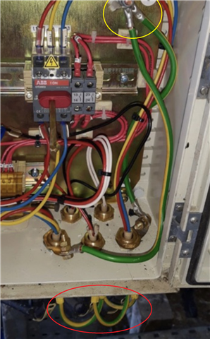

I see it a lot where the SWA isn’t serving as a protective conductor which I know it must still be earthed at one end due to being an exposed conductive part. My question is if multiple SWAs are all earthed at the supply end and meet again at a bit of equipment if we then connect all the SWAs together locally is this still classed as earthing even though they are already earthed at the supply?

    Now the actual question, which is slightly confused. Are you asking if the SWA armour is an Earthing conductor under your conditions, then yes. If it is only connected one end then No. Even if you put an Earth G/Y cable alongside an SWA, the armour can still act as an Earthing conductor too, the current will share all the parallel conductors depending on the resistance of each.

    The armouring of any S.W.A. cable can't be an exposed-conductive-part cos it ain't exposed to touch. It is covered with insulation.  But it definitely does need to be properly glanded and earthed at it's origin. (And at its load end as well in most cases).
    Also, the S.W.A. is not an extraneous-conductive-part as it forms part of the electrical installation. (See definitions)
    I would say that the conductive steel wire  armouring is more accurately described as a circuit protective conductor. I often use it with two core cable as such.

    I disagree with this. If a core in the cable is used as a cpc, then the armour is only an extraneous exposed-conductive-part. It can be earthed at one end only (usually the "source" end).

  • It cannot be earthing (CPCs) because those cables clearly do not provide a path back to earth.
    That is clearly not true, as current due to a fault in one of the cables will be carried back down another cable. The armour acts as "conductors in parallel".
    presumably the exposed conductive parts are electrically continuous at the supply end.
    OK, but isn't that how the copper conductor is used when it is provided in parallel with armour?
  • well if you are not sure if a green/yellow  wire is earthing or bonding, ask what happens if you cut that link ?
    1~) would you remove the CPC  - the return path for operating the ADS. if the ADS would be disabled,  that is a CPC or earthing.
    2) would you only remove a conductor that keeps the touch voltage down during a fault but does not remove the ADS - this is bonding,
