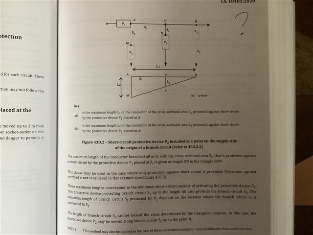

  • Maybe someone can explain this?
  • Just a nice simple 3m rule will do me!
  • Not a standard I'm familiar with and I can't see the context, but my guess is that I think they're saying that if you have one protective device protecting two difference c.s.a. cables, that the total length that can be protected varies depending on proportions of the lengths of the two types of cables - as added together they need to meet the maximum permissible loop impedance.
    For instance, say your protective device can protect either 10m of a 'thick' cable, or 5m of a 'thin' cable (before increasing loop impedances mean that disconnection times get too long), then you could have:
    0m of 'thick' cable feeding 5m of 'thin' cable, or
    5m of 'thick' cable, feeding 2.5m of 'thin' cable, or
    10m of 'thick' cable, feeding 0m of 'thin' cable, or
    anything in between, so long as the proportions still add up to 1 - so 25% of your thick cable allowance means you can have at most 75% of your thin cable allowance, or 33% vs 67% or 99% and 1%.
  • It is just ohms law made incredibly complicated by an unnecessary nomograph.. Basically how far along you can slide line tap with a length of thin cable along a fatter distribution cable and achieve the same PSSC at the ends M,N and B. It is the street main and house radial situation.
    It deserves a prize for being a really, really poor explanation, and I rather wonder if the authors did not grasp the simplicity of the point either.
    Which document is it from ?
    Also of course short circuit faults are something of an ideal fantasy - in reality all faults have some voltage drop, if they did not there would be no energy dissipated at the point of fault, and no flash no heat and no sound.
    Mike.
  • It’s from Annex43D of IS10101 2020, effectively just an informative to the equivalent of Chapter 43 in BS7671 although the Irish Standard refers to it as Part 43! I vote it as the worst attempt at an informative explanation in either standard. It looks like it was taken from IEC 1246/08, whatever that is. I didn’t get it until AJ explained so perhaps the authors didn’t intend the readership to extend to duffers like me!
