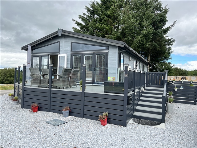

    These lodges are new lodges are built to the latest BS3632 standard. Like your comments they are connected to Mains Water, Private Sewerage System, LPG Gas but they are connected to the DNO PME earthing system. We pay Council Tax as this is our only home.
    It arrives on site via Low Loaders and the 2 sections are put together by the Lodge Manufacturer, They are situated on blocks etc and would have to be dismantled and transported on Low Loaders.
    The majority of the Lodges have a Canexel outer covering.
    They are really well insulated nowadays.

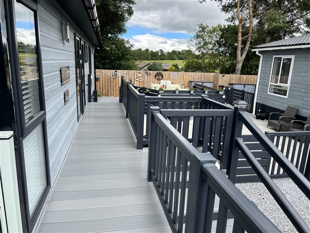

  • Just looked at CanExel cladding, heat compessed resin and natural fibres. So, along with pvc doors and windows, seems that no major exterior parts are connected to the DNO earth. But what MAPJ and Lisa mentioned holds true for anything that is touchable and connected to DNO earth  when you are barefoot on wet grass. Light fittings, chassis, outside tap, not sure what else, pic might be good, we can all get a bit jealous.

  • Agreed, i just wanted to see pics though Andy Slight smile

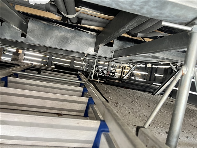

  • Water pipes are plastic. Only part I can see would be problematic would be the chassis.
  • Only part I can see would be problematic would be the chassis.
    Unless there's metallic contact between the chassis and anything accessible inside (possibly unlikely give modern methods of construction), the the chassis could be left unbonded - so avoiding the PME issue.
  • Ordinarily, I'd wonder why anybody would be going near the chassis, but then I noticed the stepladders.
