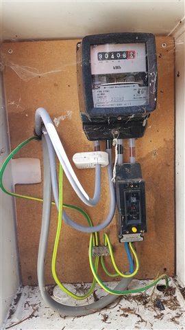

  • I am sitting in my van outside a licenced HMO having just replaced a heat alarm in the kitchen because someone left a tap running in the bathroom above it.
    I have just checked the installation earthing for the Minor Works Certificate, the last EICR was 2020 ago so the next is due 2025.
    TT with a dual 30mA RCD plastic consumer supplied by a six metre 16 mm T&E distribution circuit.
    I would have hoped for better, but I  am not surprised.
    I don't think AFDDs will even be mentioned for three years, unless I put a comment on the MWC.
  • I should perhaps also comment that the intake and suppliers fuse is actually in a cupboard in the front room which is being used as a bedroom with the tails running out through the wall and into the meter box, so the meter tails themselves are a couple of metres long.
  • that VOELCB  is not wired properly - follow the green/yellow ;-), still I guess it makes a handy isolator. Also  I hope that the meter box has its lockable door,  as if not there is single insulation accessible without a tool.
    Otherwise from your description to be honest it does not sound too bad.  At least it has an RCD or two, probably AC types but we cannot have everything.  The post 2004 colours on the submain suggest that someone is looking after what could quite easily have been cotton covered rubber.
