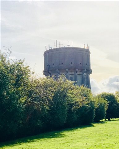

  • An Anglian water employee suggested changing the main water stop cock in the chalet that I visited. The incoming mains' pipe is black plastic that reduces to a small diameter internal pipe under the sink. We have lots of water towers around here to supply consumers. It concerns me that the towers are liable to imminent collapse what with all of those heavy aerials on the top.

  • In my teens and twenties I lived in my parents house that was supplied from a water tower, basically the same set up.
    we had oversized water storage tanks in the roof and generally everything worked at our house, however neighbours complained so the eater board had a fiddle and upped the pressure.
    As general builders we were going around replacing ball valves and installing hammer arrestors because of the issues caused by the higher pressure.
    Eventually the water board dug a trench and linked two radial mains together to create a ring thus increasing the flow, then they reduced the pressure again.

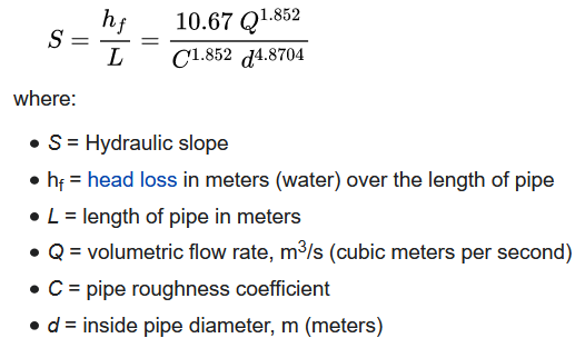

    Note that pipe resistance is not very like ohms law, it is non-linear, or the resistance is current dependent if you like.
    The Hazen Williams approximation is commonly used for simple clean water pipe runs.
    The coefficient C is perhaps 100-120 for a rough concrete pipe and 150 for a smooth bore plastic one.
    The two killer facts are that the pressure drop rises almost as the square of the flow rate, so to double the flow in the same pipe almost quadruples the pressure drop;  and is divided by almost the 5th power of pipe diameter, so doubling pipe diameter gives you ~ something like 26 times the volume per minute for a given pressure drop.
