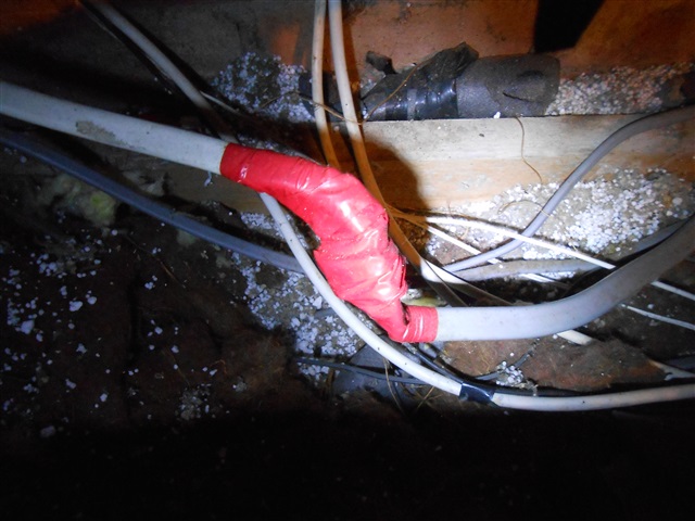

We do not normally inspect cables hidden under floorboards, concealed in walls or in roof spaces. Perhaps we should despite the disruption. I have just carried out an inspection and test of an old bungalow where Mr. Bodger was the previous owner. I have found many horrors. I had to dismantle some woodwork in the corner of a room where the cupboard contained numerous dangerous horrors, including the item pictured below. It supplied an immersion heater in the loft. I had to gain access to the cupboard to extend cables and provide correct junction boxes to replace choc-block joints.

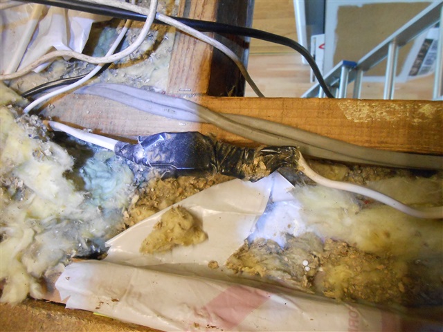

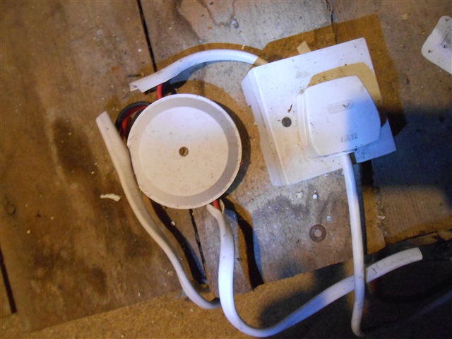

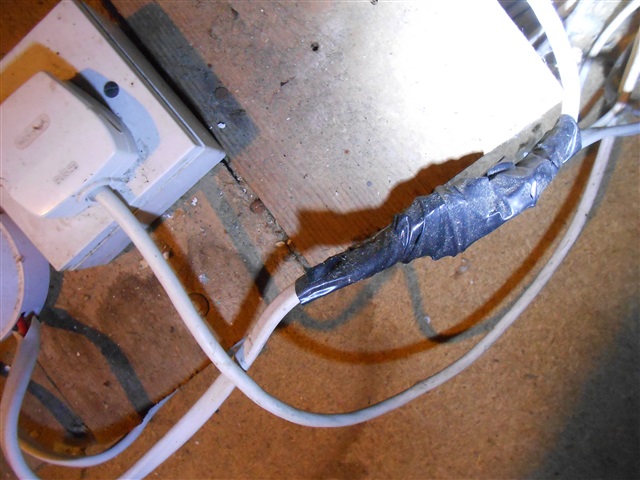

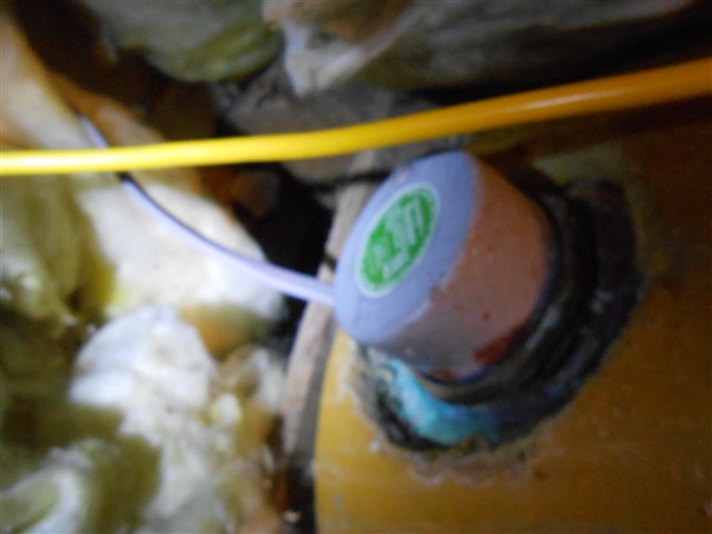

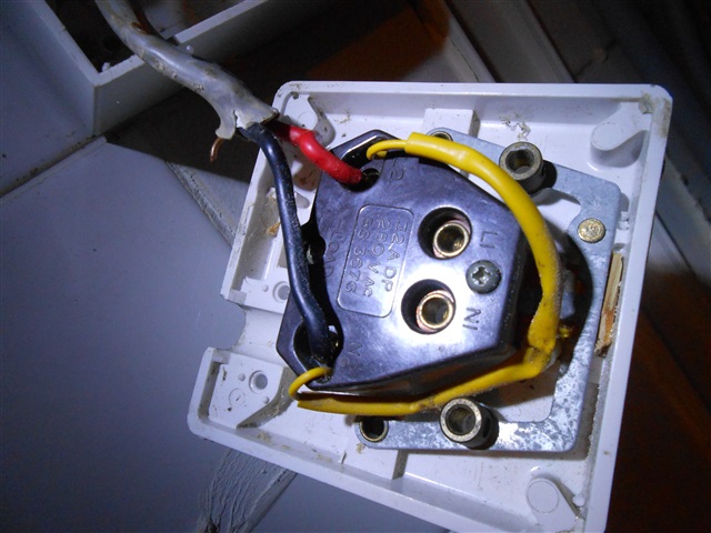

  •   No wind up all. Here are more photos of Mr. Bodger's work. Most hidden under loft insulation, and some open to view.
    Ref. double pole immersion heater switch. C.P.C. cut back and not used. I suppose you can't use a C.P.C. if the two earth terminal screws are missing!
    Immersion heater supply wired in ordinary P.V.C./P.V.C. cable.

  • Are those splices with choc blocks under yards of tape really a mortal sin? OK, they are double-badger, but are they unsafe?
  • 526.3 and 526.5 Chris. Every connection shall be accessible for inspection, testing and maintenance. So hidden joints in walls or under thermal insulation are NOT in compliance with B.S. 7671. And, considering the state of the first example that I showed, I can not trust that any others in the installation will be mechanically and electrically good. Especially if covered in sticky tape.
