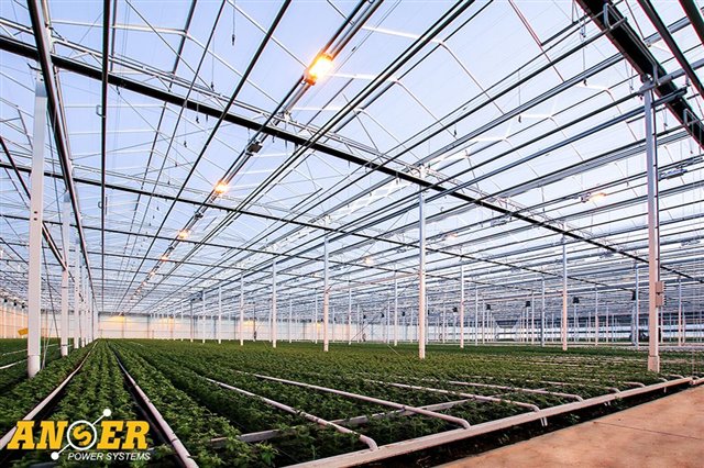

  • Would you bond my greenhouse here illustrated at the bottom of my garden?
    What's the earthing arrangement and means of protection against electric shock?
    If it were TT, would it need a separate earth electrode (depending on construction of the metal structure)?
