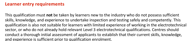

In order to be able to inspect against Edition 18, what qualification is required? I've been referred to City & Guilds 2391-52 Level 3 Award in Inspection and Testing...
One of my Engineers is IEng with IET, and has various C&G qualifications including City & Guilds/NICEIC – BS 7671:2018+A2:2022 (18th Edition Wiring Regulations). Through these and associated experience he is qualified to higher than Level 3 (Manager/Coordinator Level I'm told).
Is this sufficient to be able to sign the inspection forms? I did see in a previous thread that there isnt an actual formal qualification, so I think the above would be sufficient, but that thread was 2 year ago.
Thanks...
  • Indeed! As I understand it, great debate was had about candidate entry requirements for the 2391 and the equivalent EAL qualification, some arguing that only those with a recognised NVQ L3 qualification in electrical installation work should be allowed to take the course.
    The recently introduced electrician + courses in PV and battery does restrict entry to only those practicing electricians with the L3 NVQ. So that's me out but it might also exclude the authors of the COPs that the courses are predicated on?!
