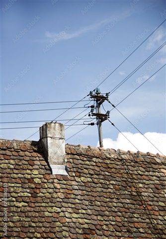

    I know there seems to be some UK nervousness about using all 3 phases in a domestic setting,  but much of Germany has been doing it that way since before the war without significant problems.  Many are not obvious, being underground, but there are plenty of  overhead to the house 'Dachstanger' = roof post supplies  in use. It may be we worry too much.
    Mike
