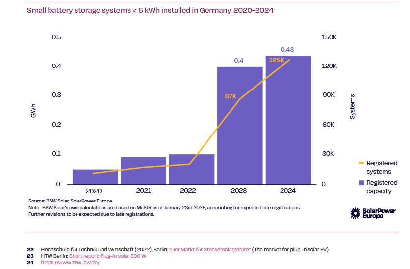

  • Looking at the plug in battery situation, recent figures for Germany suggest about half a gigwatt-hour of plug-in "small battery" storage  a couple of years ago.
    Figure taken from this report.
    https://api.solarpowereurope.org/uploads/Solar_Power_Europe_Plug_in_Solar_PV_Briefing_Paper_20250312_V02_6dbb591d88.pdf?updated_at=2025-03-13T08:55:01.182Z
