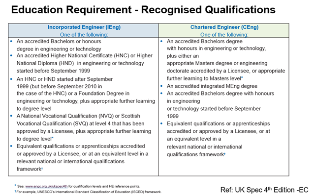

I’m looking for some advice regarding my eligibility for Chartered Engineer (CEng) registration through the IET.
I’ve been working in the wastewater sector for the past 16 years, with 13 years of post-degree experience. In January 2024, I was promoted to a Senior Technical Officer role, where I now manage and supervise complex engineering works, lead teams, liaise with public and private stakeholders, and oversee procurement and project execution.
Although I hold a Bachelor’s degree in engineering and not a Master’s, I’ve been taking on responsibilities at a level I believe aligns with CEng competence requirements.
Would my extensive experience and current role be sufficient to meet the academic and professional requirements for CEng, or would I first need to complete further academic study?
Any insights or shared experiences would be greatly appreciated.
  • it's about the job you do, not the pieces of paper you hold. somebody better informed than me will have the statistics, but more people get CEng without MEng than with it. colleagues of mine have achieved CEng with no formal qualification higher than an HNC
    find a Professional Registration Advisor and have a chat with them

  • Hi Krishnaduthsing. I just wanted to echo Dave's comment about academics Vs CEng. I myself haven't got a Masters (a BSc) - however I achieved CEng. It's about demonstrating beyond doubt that you've met the standards set out in the UK-SPEC.
  • Thank you very much for sharing your experience — it’s really encouraging to hear that you achieved CEng with a BSc. That gives me confidence moving forward.
    Just to clarify, in order to fill the academic gap between my degree and a Master's level, should I submit a separate technical report alongside my Employment History report in the career manager? I’d really appreciate your thoughts on that.
  • Hi,
    No you don't need to. All you need to show is what you are doing now and your career history that got you there. What you submit is exactly the same whether you are applying with a Masters or with no qualifications at all.
    Just to support the comments above, as a PRA I have hardly ever seen anyone apply with a Masters. And to emphasise Dave's point, I strongly suggest you do contact a PRA (not me unfortunately as I'm full up with applicants!) as we can can explain how you show your experience in your application.  www.theiet.org/.../find-a-professional-registration-advisor

  • To add to the confirmation, even if a little late, I gained my CEng without any formal engineering training. I graduated with a Batchelors in chemistry and started working as a bench chemist before translating into more engineering based work. If you can demonstrate that you are doing high quality engineering work and can meet the competencies in UK-SPEC then you're good.
    Good luck with your application.
