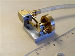

    When you have got your machines in good working order here's a project suggestion: A breath powered piston valve engine, 6mm bore.
    https://youtu.be/qoLbLisxNLU
    It's good as an icebreaker when starting to talk about engineering, just take it out of your pocket and give a blow (it also doesn't smell like my IC models do)

  • Yes, I like those, I'd also like to have a go at a miniature Stirling engine sometime - but many other projects to come first!
