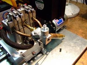

  • I am making an SU style carb for my 12cc two cylinder engine. The model aircraft style carb I am using at the moment does not match the engine well enough under load. The round body is 15mm diameter.
     This video is of a load test with the simple carb.
    Best regards
    Roger

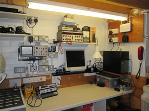

  • Following a tidy up this afternoon:-
    http://www.ancient-mariner.co.uk/public/Clear%20Bench%201.JPG  In better definition.
    The current project below, fitting a GPS Receiver, Ovened 10 MHz Xtal Oscillator and a GPS Antenna Splitter with DC pass through together with a PSU into a new case. I have always been a bit wary of those open mains terminals!
    http://www.ancient-mariner.co.uk/public/GPS,%20Time%20&%20Frequency%20Project.JPG  In better definition.

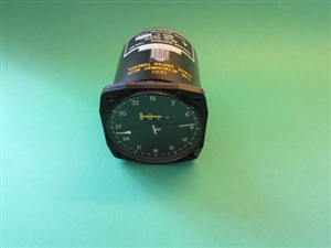

    One of my other current projects is collecting together what can be best described as memorabilia.
    Here is a sample:-
    Again for better definition: http://www.ancient-mariner.co.uk/public/Instrument.JPG
    Clive
  • That's a nice playroom Clive ? ? Plenty of sockets and a red telephone in case of emergencies such as needing a cup of tea.

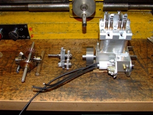

    Lisa, the engine is intended for model tractor hence the need for flexibility under load. Propellers are a much easier prospect, as the revs drop the load drops. It's hard to stall and engine that's driving a propeller.
    An early mock up:
    Best regards
    Roger
