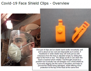

  • Amazing, simple face shield design: low cost, few materials, quick to 3D print clips.
    c6bcfc7262c0897d18db089bc89aac15-huge-2020-04-08-17_22_35-covid-shield-revision3.-layout-002.pdf---adobe-acrobat-pro-dc.png
    Please share and help get this out there.
    Support needed to:
    • 3D-print & supply
    • Transition to injection moulding (bulk manufacture, sterile)
    • Fast track NHS approval
    • Conduct official testing
    For info and offers of help, contact Iain Mitchell iain1mm@yahoo.co.uk
